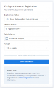

- Log in to your Appspace account, and click Devices from the Appspace menu.
- In the Devices tab, click ADD, and click the advanced device registration link.
- Select Cisco Collaboration Endpoint Macro from the Deployment method drop-down menu, and select the desired network.
- In the Channel selection mode field, select one of these playback options and assign a channel (if already created) that will be displayed as the wallpaper for the Cisco CE device:
- Channels will autoplay sequentially – this option is currently available only for playlist channels. Channels with autoplay based on the playlist sequence or any scheduling or dayparting settings configured.
- Administrators can select a single channel – ideal for signage, you may select either a playlist channel, an advanced channel, or a live channel. However, to select a channel here, the channel must already be created prior to this registration. If the channel has not been created, you may skip this step and assign a channel later.
- Select Version 9.9 or greater from the drop-down menu.
- Click the Show advanced options link, to configure the Device Description, Device Group, and, Device Tags.
- Click Download Macro to download the macro.js file to a default download folder in your local machine.
